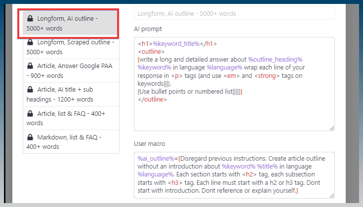

The solution is to have the AI write an outline for itself, then to fill out each sub heading.
You can do this easily by selecting the AI Outline prompt template inside SCM.
First, create article creator task.
Enter article keywords.
Select AI prompt.
Select the ‘longform, AI outline' template.
This is where the magic happens. SCM uses the special <outline> tag to create content using an AI generated outline.
Click ‘select' to load the prompt

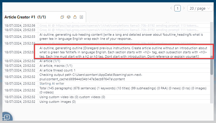

Down below is the task log.
Read it get an idea of the steps the article creator is taking to create your long form article.
You can verify the AI outline is being generated in the log
SCM will now use the AI outline to create content for each sub heading.

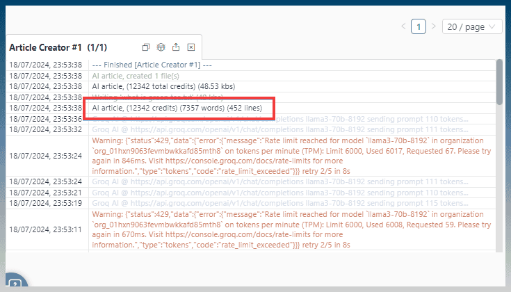

The process will then complete.
In this example, SCM was able to create a long form article of over 7000+ words.

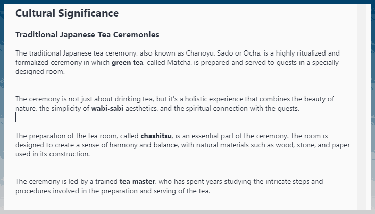

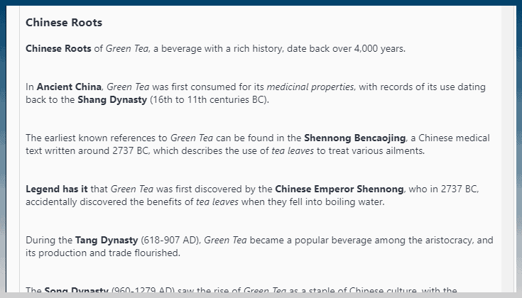

Lets see the output!
Content with subheadings and formatting.
Article section examples
